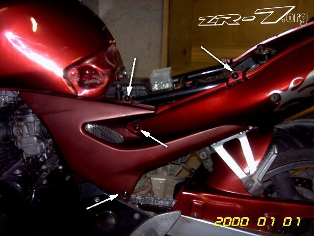

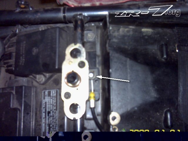

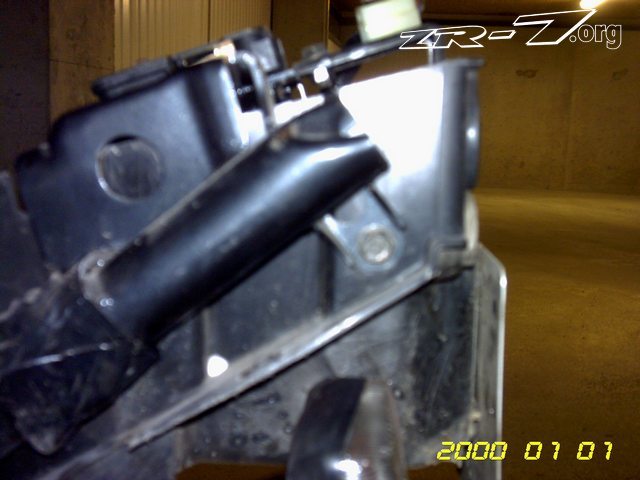

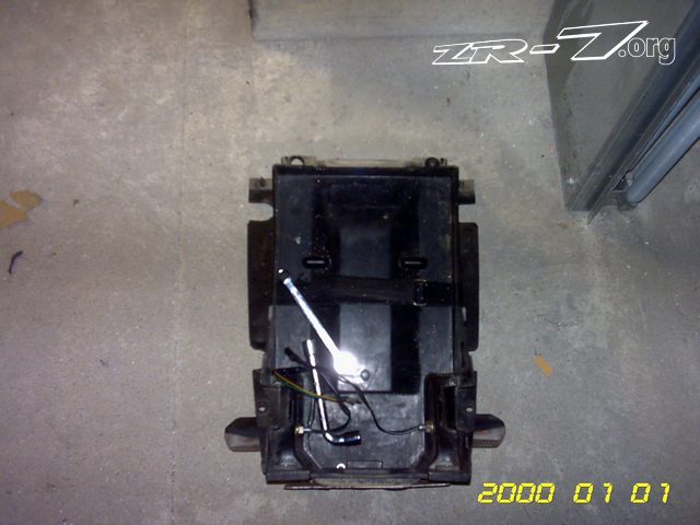

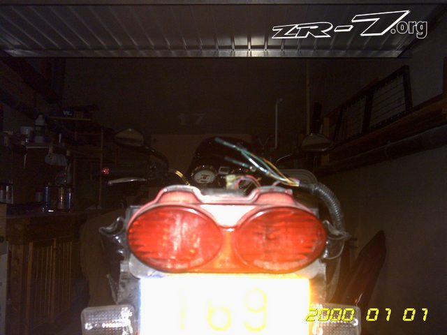

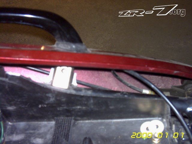

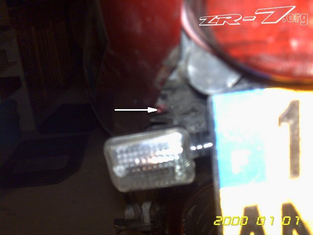

DEPOSER LA SELLE
DEVISSER DEPOSER VIS DES CACHES + COQUE ARRIERE (8 VIS ,TOURNEVIS CRUCIFORME)
RETIRER LES CACHES
DEVISSER DEPOSER LES 2 VIS DE LA COQUE (TOURNEVIS CRUCIFORME)
DEVISSER DEPOSER LES POIGNEE PASSAGER ( 4 VIS  CLE ALLEN)

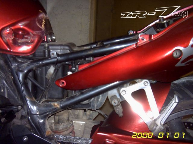

COMMENCER A ENLEVER LA COQUE ARRIERE

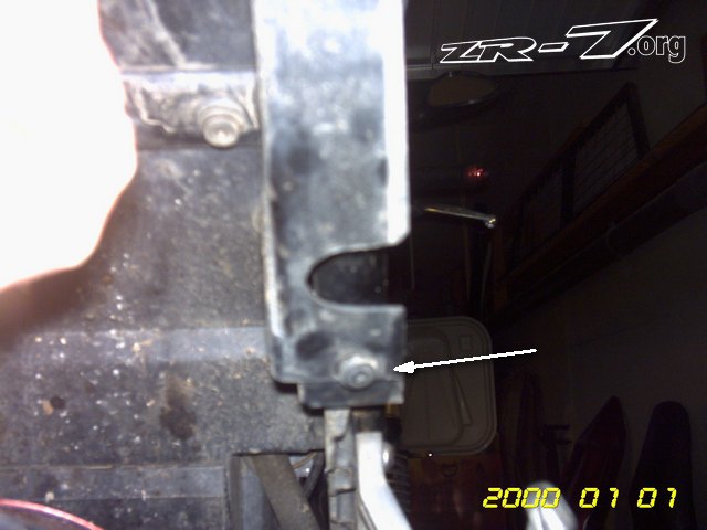

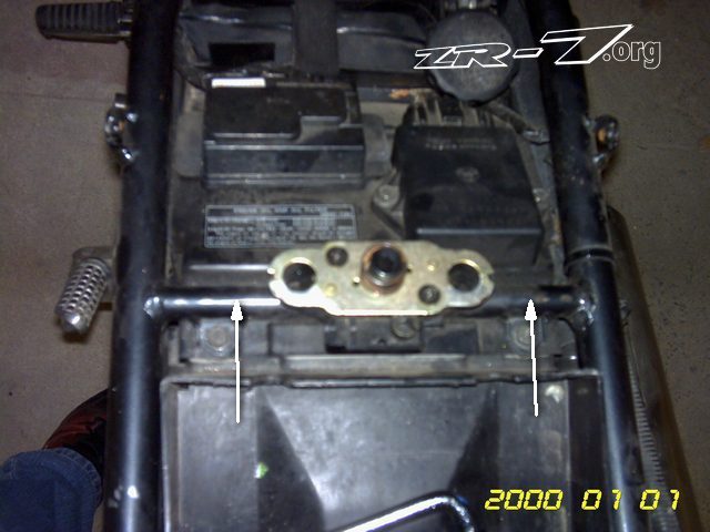

RETIRER LES CABLES POUR ENLEVER LA SELLE
RETIRER LA COQUE ARRIERE

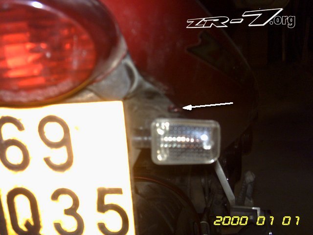

DEBRANCHER LE FEU ARRIERE + LES CLIGNOTANTS

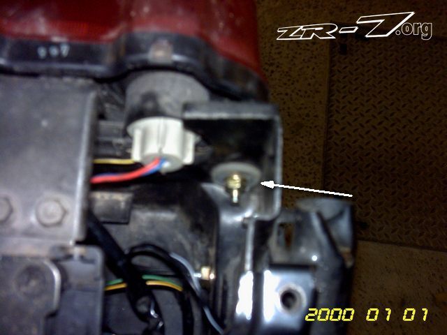

DEVISSER DEPOSER LE FEU ARRIERE ( 2 VIS CLE DE 10)
DEVISSER DEPOSER LE PDR ( 6 VIS 2 CLES DE 10 + TOURNEVIS CRUCIFORME)
DEPOSER LE PDR
